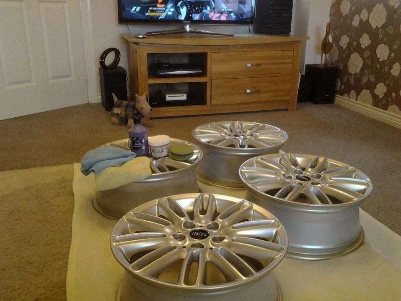

I think these are the crown wheels? (They're my winter set!)
