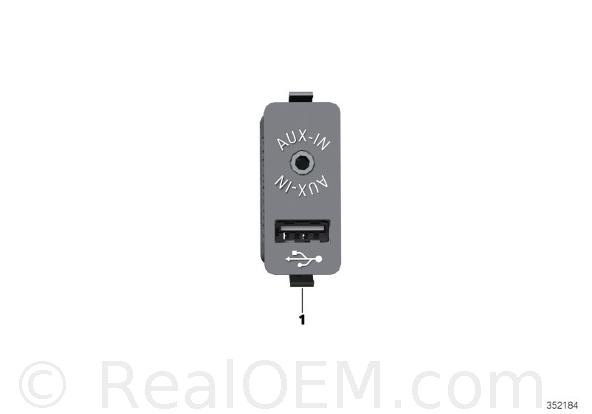

The USB socket is listed as a spare part - part number 84109266607. My guess is that that the socket has a multi-pin plug on the back that the wiring harness plugs into, so if you can physically get at it, swapping it would be easy. This is the parts diagram illustration.
Reactions: 3
The 'original' BMW/Mini parts diagrams are at RealOEM: http://www.realoem.com
After you've visited once and searched for your own car, the site will remember that and jump straight to your model.
