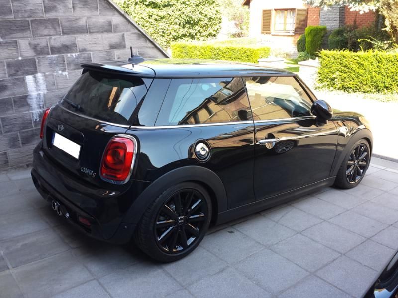

KW have delivered the goods!
Not my car, but a guy from Belgium (he's on this forum I think!!) :)
My set arrives on the 26th - I can't wait now Ive seen these pics!
The good news is that he also says he has about 20mm of clearance against the struts with his OEM wheels fitted too, which is good news for my 18x8 ET45 set up and 205/40 18 tyres. The bad news is that his 18x8 ET35 wheels are too aggressive against the wheel arches, so he is having to have his milled down to make them ET45. Heres a pic of his wheels on before the milling.
185 Posts
Not my car, but a guy from Belgium :)
The good news is that he also says he has about 10mm of clearance against the struts with his OEM wheels fitted too, which is good news for my 18x8 ET45 set up and 205/40 18 tyres.
The bad news is that his 18x8 ET35 wheels (with 215/40 18) are too aggressive against the wheel arches, so he is having to have his milled down to make them ET45. Heres a pic of his wheels on before the milling.

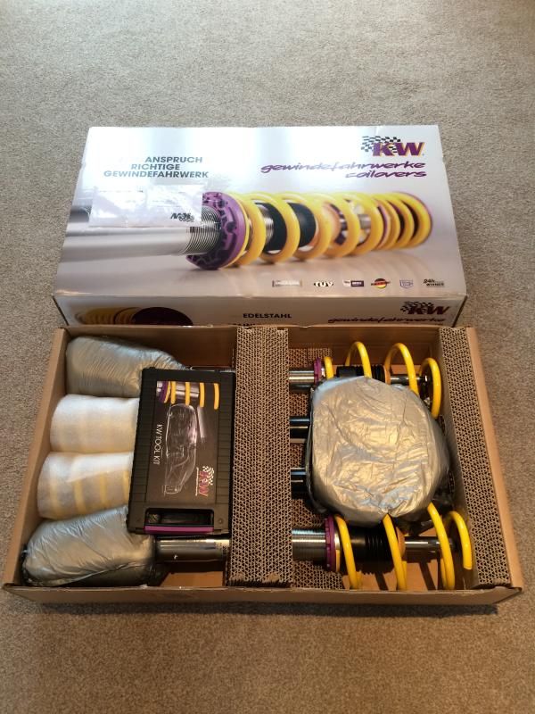

Bit of a duplicate post, as I've just updated my project thread, but for those who are interested, here's the first set of KW coils in the UK for the F56!!
Many thanks to my pal George for sourcing me these - if anyone is interested in cheap KW coils, he is the man to speak to!
Unboxed a front strut and they seem to have replicated the indent from the OEM suspension which should hopefully mean I can get my 18x8 ET45 wheels on without a spacer (they currently fit fine on the OEM set up)
Indent on the KW's:
Indent on the OEM's:

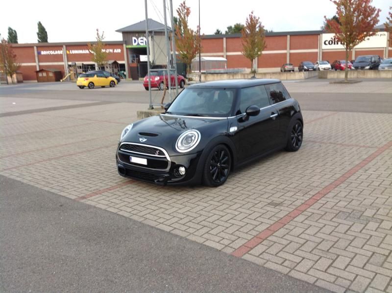

Don't want to make duplicate posts, but for those who don't follow my project thread, here is an update on the KW coils.
I got mine fitted today and they are pretty much as low as they will go! :)
The good news for F56 owners is that I can confirm that 18x8 ET45 with 205/40/18 tyres DOES NOT need a spacer (with KW coils at least, I can't comment on the BC's.) The bad news is that this set up is pretty much as aggressive as you can really go without encourtering unesscary headaches with fitment.
The fronts rub slightly on full lock when negotiating heavily cambered roads / drives at medium to low speeds, but its fine everywhere else. This will be solved with camber plates as and when they are available to order. Camber plates will be essential as currently I can only get -0.4 degrees camber with the stock set up. The rears don't seem to rub at all and I've had -2.4 degrees of camber dialled in, which obviously helps.
Pictures:
My driveway is rather difficult to negotiate now :(
