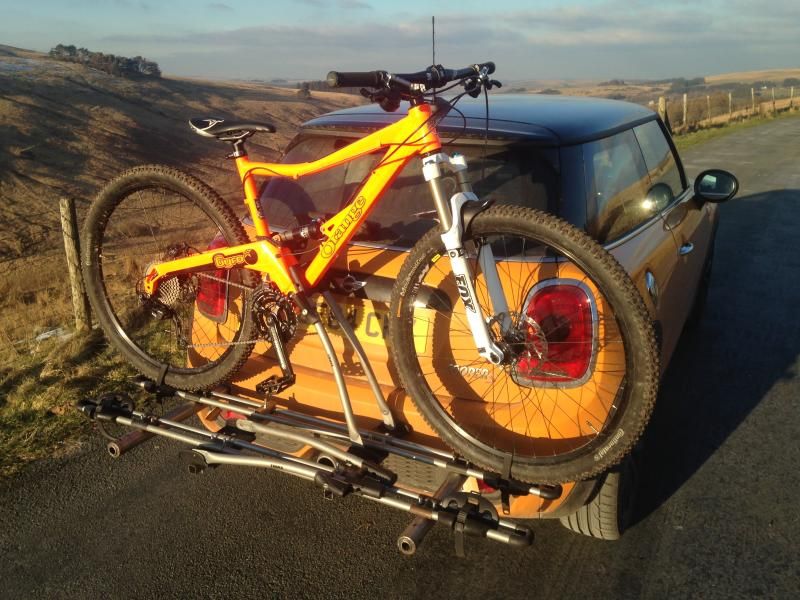

The only things that winds me up about my mini, the fact that the options for bike rack etc is shocking!!! Having not being made aware of the option to have fitted roof bars etc, i took inspiration form older spec bike rack's and my friend thats an engineer made me a rack solution for my car.

I've seen provisions for installing rods like these on custom parts web-site. I'm presuming you didn't have the bike rack prep with the threads only on one side -- how did you make it work? Also, are the bike rack brackets a stock solution? Looks like a cool solution and I'm curious as to how you did it!
53 Posts
Discussion Starter · #4 ·

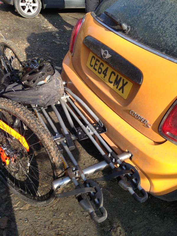

Hi, no on my car i only had the thread on the right hand side for the towing eye, what we did, took a lump of aluminium, machined and milled a blank replicated what you see on the drivers side, tig welded it into the alloy slam panel behind the bumper. put the bumper back on, then made the posts, there is a bar that goes right through the tube that you see thats holding the back racks, that allows the thread to thread in with out rebuilding the whole rack system every time. very effective, i have no idea why Mini didn't just add the second thread in the left side from standard.
Hope this answers some questions, i will get some more pics of the actual bars if you want.
Cheers

Excellent--thanks!
Curious -- did you have to remove the bumper itself or just the bumper cover?
Hi, we removed the whole bumper and the slam panel behind..
This was the first post made, then we needed to remove the bumper to think of a solution to mount the second post,
with the bumper removed you can seen the alloy slam panel, which was then removed.
Mille out the hole for the new receiving, which we replicated from the original factory piece.
Hope this answers some questions?
Thanks,
MicrowaveDave
