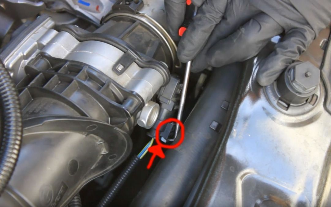

So I ordered the NM Eng Power Module and while installing it I pulled a clip to hard and it shot off.
It's the light grey locking clip.
I've posted on NAM about it, chatted with ecs, placed a phone call with outmotoring (they are trying to find out what it is), and emailed nm eng.
I'm about to drive from NY to Florida on Friday and don't need this getting loose while I'm driving. Plus I'm going to the dealer next Tuesday so don't need them question it.

407 Posts
That looks like, according to my research, the T-map sensor. I would have to say you would be hard pressed to find the individual clip for that. There's probably a reason those clips can break off easily (I would guess).
You may have to shell out the $130 ish for the part.
T-Map

I noticed those clips in two other locations. One connected to the engine and the other connected to the Mass Air Connector (to the air intake).
407 Posts
What that looks like is possibly just a generic 3 pin adapter. You can buy a repair kit for about $16 and you might be able to cannabalize the clip from that!
Here is the diagram of the part I am referring to. It might be worth you taking a plunge to see if it is what you need. I'm going based solely off the looks in both the part diagram and your first picture.

I snapped this off too when installing NM module.
Just in case anyone was wondering, the plug works perfectly fine and is still secure (maybe even more secure) without this grey coloured tab part. The only inconvenience is that if you want to disconnect the plug, you need to use a small flat-head screwdriver to lift the tab away from the plug. I had to use a small screwdriver anyway to move the grey tab in the first place so it's a very minor inconvenience in my opinion.
14 Posts
Completely agree with Jonathan on this. However, if you don't feel comfortable without it, you can probably just zip tie the connectors together.
If you don't want to leave it as is or zip tie it, there is one connector available on ebay. It's from a dismantled vehicle.

As someone who will be installing a NM Power Module later this week (HURRY UP USPS!) this concerns me just a little.
I've already pondered the 'how not to lose it' bit and the things I can do to reduce the risk. As for removing this clip, is there a "safe" method?
Cheers
DJ
Practice on the connector to the air flow intake sensor as it's the same type of plug and much easier to access with your hands.
I want to do an install / removal video for the nm power module however it's really quite dark in my garage so I don't know how well it will turn out.
