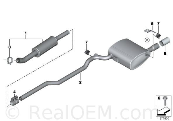

I wonder if the F56 S exhausts could be fairly easily modified by the manufacturer to fit the F56 Cooper, as it looks like the stock exhausts are very similar right up to the point where the tail pipe(s) come out of the silencer.
Cooper:
Cooper S:
